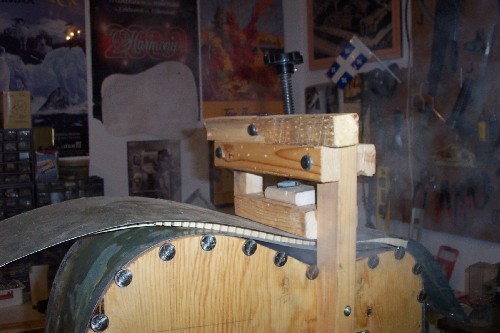

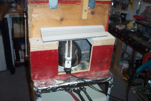

Hesh, if it can bring a bit of sun...Lst year, when i started, i steam bent my first plywood sides and it was the coolest thing that me and my Dad ever did together!
Here's a pic of my first bending machine with kettle option
You know what Hesh, we have this in common friend, we are 2 lucky resourceful guys!
Good luck with the real deal my friend!
